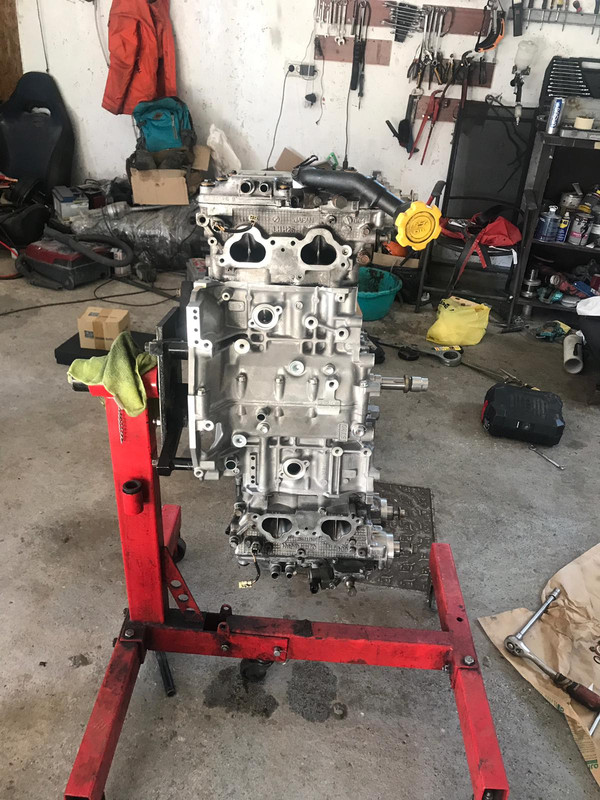

La legy am busit roata. Foresterul are inca lipsa motor.
  • 3166
Re: Forester XT '03 +motor STI
« Reply #241 on: May 19, 2019, 23:11:26 PM »
I-ai facut motorectomie.
« Reply #242 on: May 20, 2019, 12:02:05 PM »
Incepe sa capete o forma.  ::)

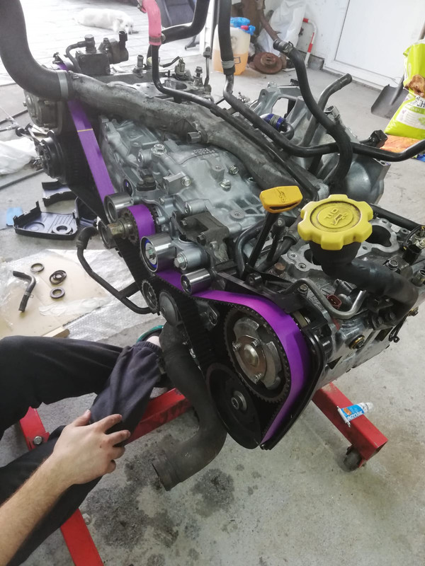

Funda aia mov e anti'deochi?  ;D
  • 887
« Reply #244 on: May 20, 2019, 14:09:35 PM »
Ai asortat cureaua cu rotile alea mov?  ::)
  • 3166
« Reply #245 on: May 20, 2019, 14:12:40 PM »
Aia creste putoarea motorului, nimic nu stiti!  :P :P ;D ;D
