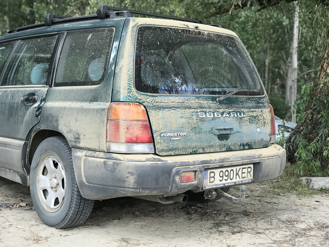

Plaja Gostinu
  • 1467
Re: japonezu' de la eclipsa
« Reply #201 on: July 20, 2020, 18:58:49 PM »
Arata si mai bine murdara :)
« Reply #202 on: July 20, 2020, 21:05:34 PM »
Mai fain decat la Mamaia :)
« Reply #205 on: July 20, 2020, 22:59:55 PM »
Asa ii sta bine unui Forester, cu noroi si praf.
